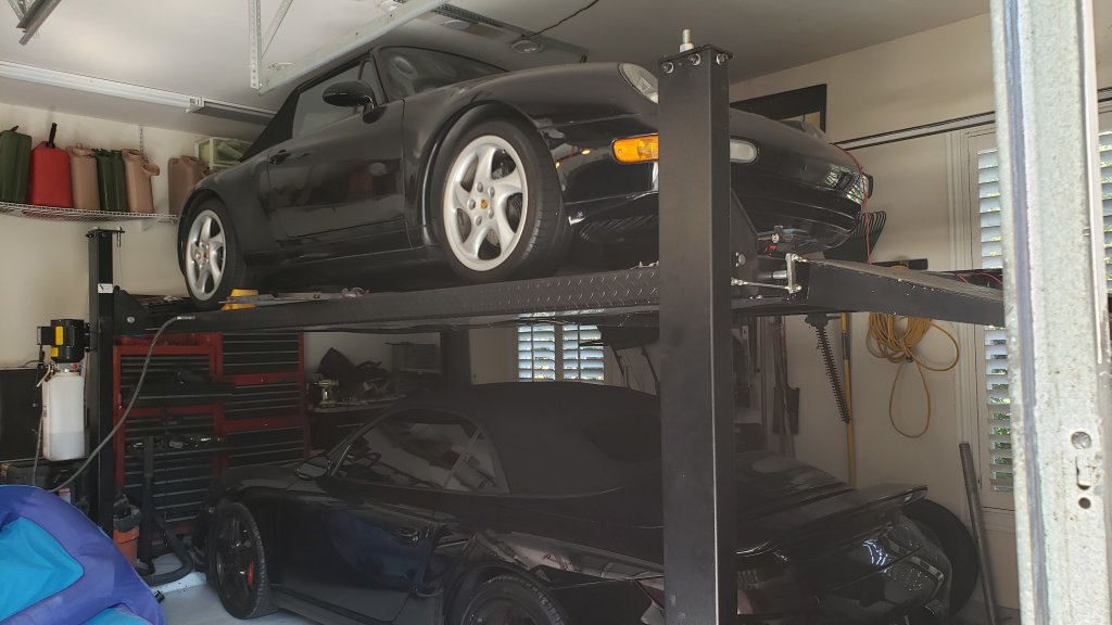

And P-car corner at Casa de Avslash. The 997TT has been visited by the Champion Motorsports fairy with 68mm turbos, intercoolers, etc. It hits boost like a modified 951 used to. Smash the throttle, look over and smile at your passenger, count to two, and wait for their look of stark terror.

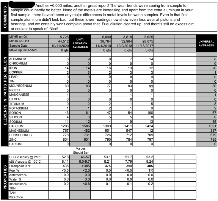

My latest Blackstone labs report below.
Note that the first report shown (2017) was based on the last time I had put on the OEM Castrol. The last three are based on using Mobil1 EP 5W-20.

That’s a nice timeline. However, I have no clue what I’m looking at. Can you help me out? Most of the numbers appear similar. Are you saying that there is very little change between OEM and the Mobil EP? Where do you show improvement? I’m curious. I started using the Mobil EP and have been happy thus far.

I should point out that I am very happy with how the Mobil1 EP 5W-20 is doing in nearly all measurements - except for the magnesium reading. I'm surprised that Blackstone doesn't bring it up. It went from 12 on that last OEM Castrol change to many hundreds ever since. But I guess all else is same or better, so nothing to worry about?

Well, the numbers are as good as or better than the Castrol. The high aluminum reading (potentially suggesting engine wear) went down. The borderline flashpoint values improved, etc. As I mentioned above, my only concern in magnesium, but Blackstone doesn't appear to be concerned.

This is a long thread, so I will re-state my plan. I used the Gucci OEM Castrol throughout the warranty period. Before I decided to switch to the Mobil1 EP 5W-20, I decided to get a baseline lab report on my last Castrol oil, which is what I did. Since then, I've been doing yearly lab reports to track the Mobil1 "performance" compared to the OEM Castrol.

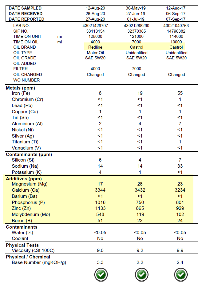

Magnesium is part of the oil's additive package, similar to zinc, phosphorus, and moly. Mobil-1 has much lower calcium and higher magnesium. Nothing to worry about here.
You want to monitor wear metals, and if using extended drain intervals, TBN.
I use Mobil Accutrack analysis, which shows the additives separate from other items. Note that Red Line has higher zinc/phosphorus/moly, but even lower magnesium.
