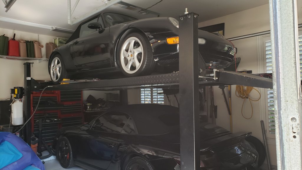

And P-car corner at Casa de Avslash. The 997TT has been visited by the Champion Motorsports fairy with 68mm turbos, intercoolers, etc. It hits boost like a modified 951 used to. Smash the throttle, look over and smile at your passenger, count to two, and wait for their look of stark terror.
Gorgeous! My apologies for taking 4 MONTHS to respond to your post, but I just saw it today...
Love the 993 Cab and the 997TT is a such a beast (and IMHO, under appreciated to date by the P-Car community). Those are two beautiful cars!!!
