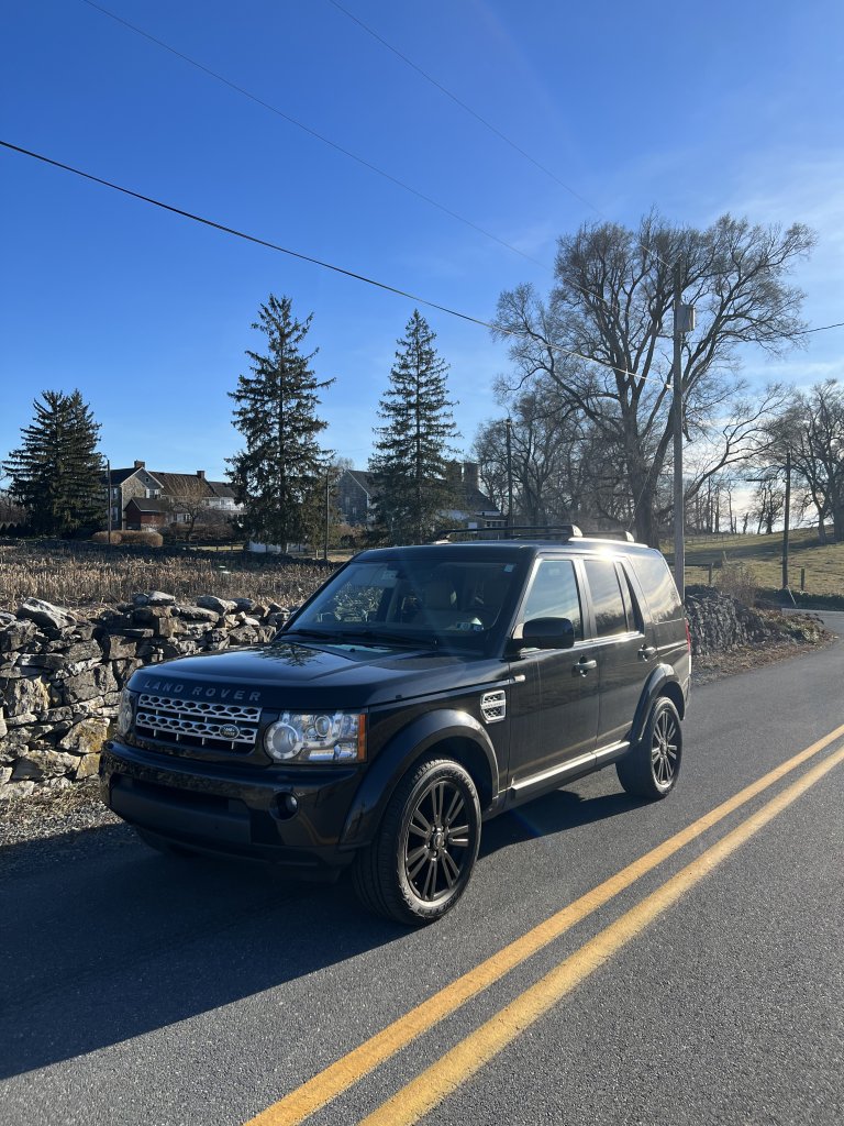

I recently purchased a 2012 LR4 with the 5.0L v8 on original timing chains with 88k miles. While the engine is noisy, I don’t believe there is any timing chain slap. However, a distinct rattle can be heard from the engine bay when cold. It’s not the failed fan clutch tick, this is much quicker and pronounced. Wondering if it’s not the belt tensioner. Any thoughts? Video below.
