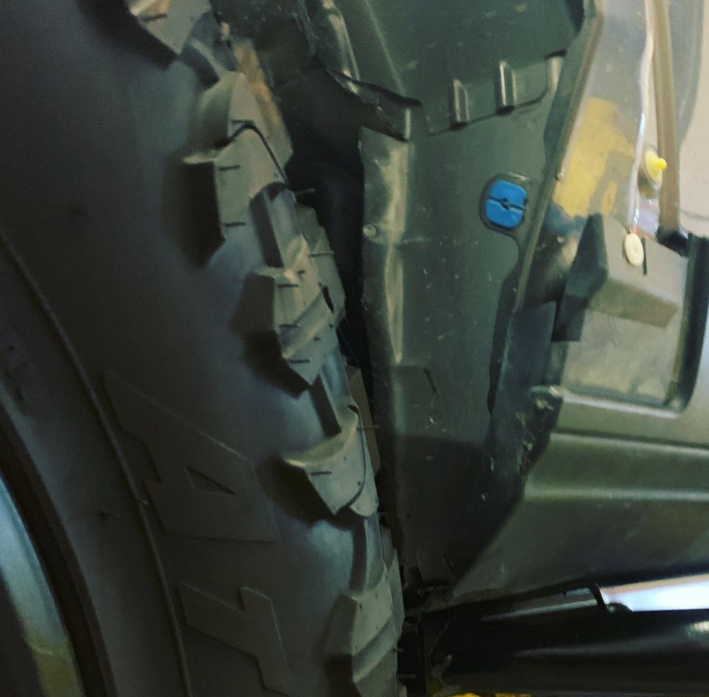

Looking at mine, I have serious doubts that 34-35 would work with the way the TR sliders wrap up into the wheel wells, but who knows.
I would also like to see pics or vid of that setup in full compression at all 4 corners. How is that not popping the fender flares?

Based on the pics on their Instagram, looks like the flares are modified.

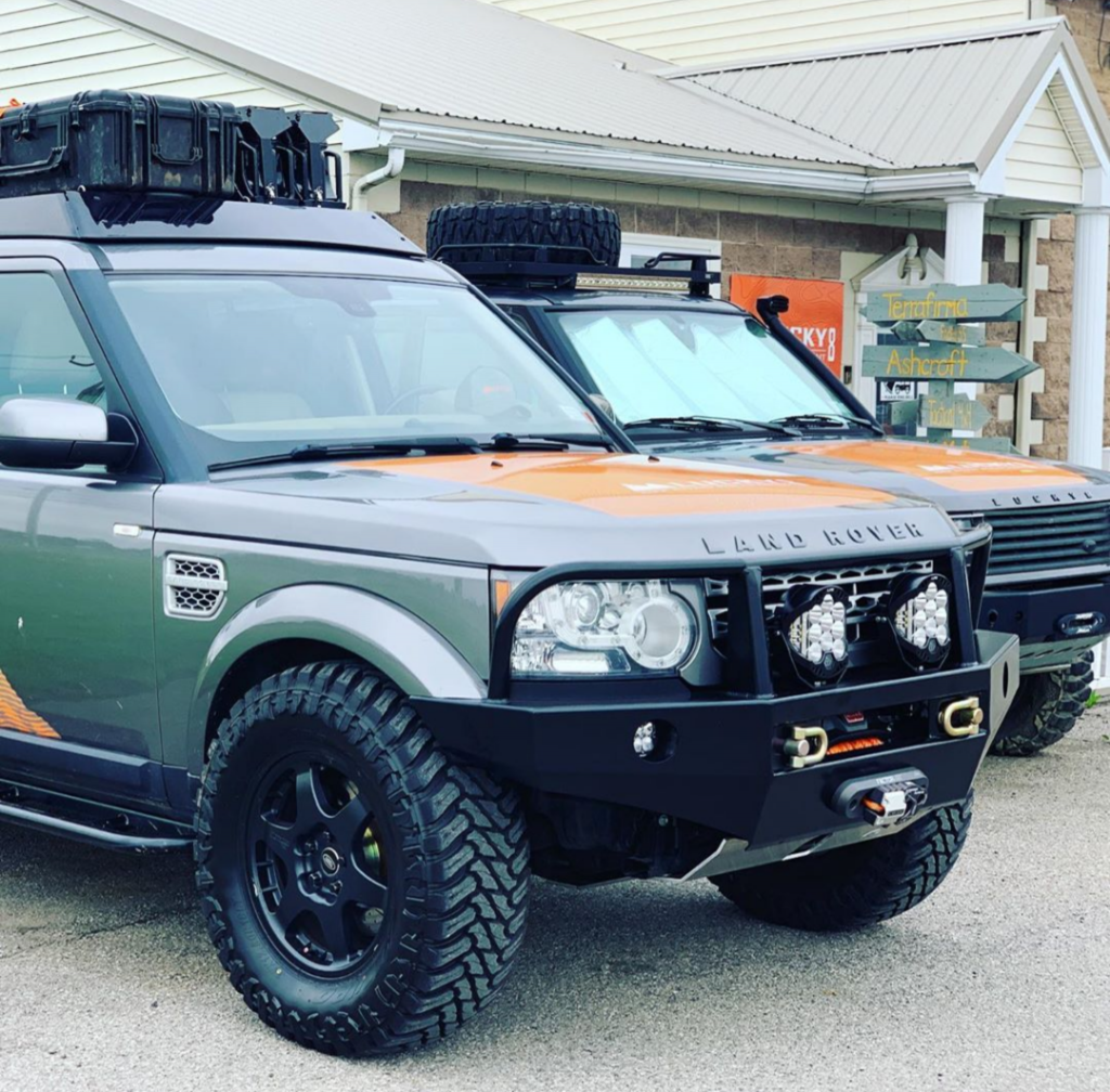

Looking at Atturo's website, they list a 34.8" actual diameter for that size.
For comparison, BFG lists comparable KO2 at 34.5.
The devil is in the details, though. Need a full description of the mods they made to accomplish this.
So far, we know:
PD1881 Compomotives
Terrafirma 1.5" Spacers
Proud Rhino Front Bumper
Assuming:
Proud Rhino 2" spacers
Proud Rhino Lift Rods
Come on Lucky8, get in here and give us the details.

I'm glad I caught this thread. I was going down this route, but had to put it aside since I found a smoking deal on KO2s.
I wheel with some Tundra dudes and they run 35s or 37s on their rigs. I bought some hub centric wheel spacers/adapters a while back to change the bolt pattern from 5x120 (LR4) to 5x150 (Toyota/Tundra). Thinking I was going to get some Method wheels with the lowest et -38 (??) and throw on some 35s like the rest of the guys. Just in case we ran into tire slashing issues out on the trail, and this gives everyone a full set if necessary.
With all that said, I'll see if I can get my buddy to lend me his spare and I'll do some tests. Mind you that the major difference here is that I'll be running 2" spacers and Toyota wheels with a higher offset. I'll see if I can get some pictures when I do this.
