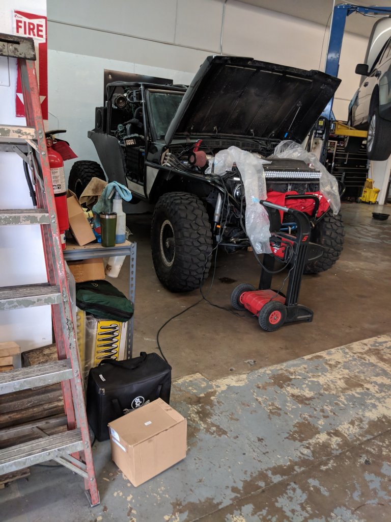

I've talked to them, but not super in depth about it. I was going to go up there once I had everything and sit down and talk to them about. I don't think they've ever tried to fit 305/55's but I know the owner of shop owns an LR3, with some pretty beefy 18's. I forget exactly what size they were

This is the kind of stuffs they do, so I'm sure they'll be about to get 33's on
