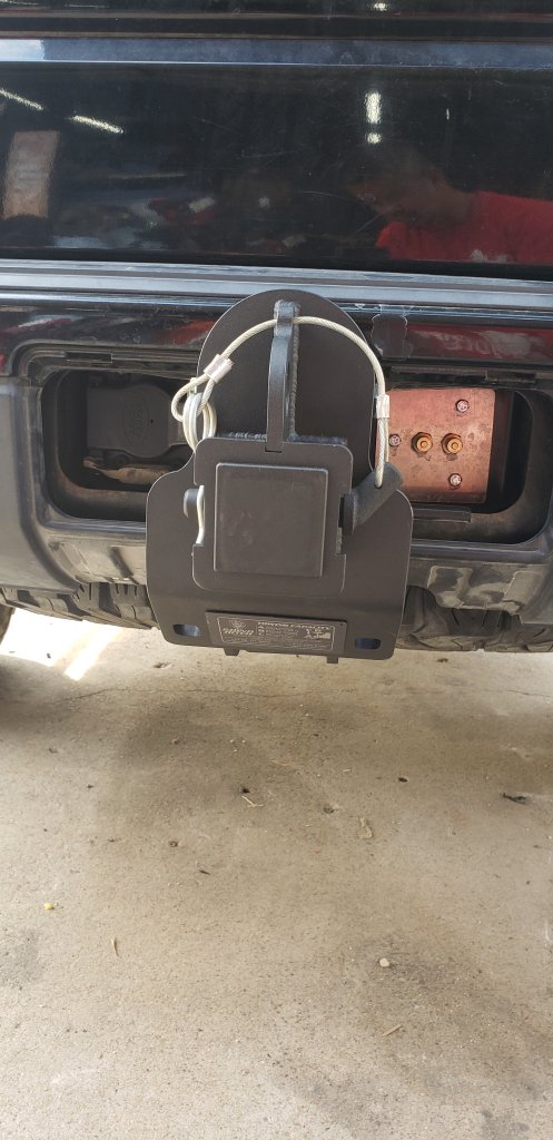

So, I finally got my Rhino hitch. Do you guys use the hook plate? Can I go without it, since it digs into my spare?

Can you drop your spare, install hook plate, deflate spare a little and reinstall?
That's exactly what I did. I'm running 255/70r17s KO2s and that's about 31", which barely fits after fully deflating and squeezing it in.
I'm looking for either a hitch swing out arm that doesn't hit the lower tailgate or a full rear bumper with a tire carrier.
I would definitely install it per the directions and use all provided parts.
Can you line up the hook with an open tread in your tire or is it way too tight overall?
