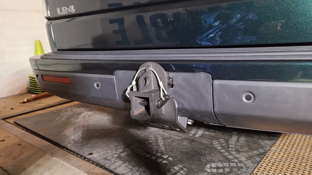

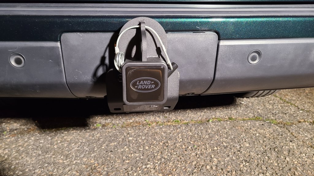

Alright all, after several start and stops I now have my rhino ox hitch installed.
I saw someone mentioned that the lr4 and lr3 bushings were mislabeled... the lr4 I used was definitely the smaller of the two and a little loose but ultimately fit well. The other was larger and would have had to be banged in. Think I may have used the wrong one?

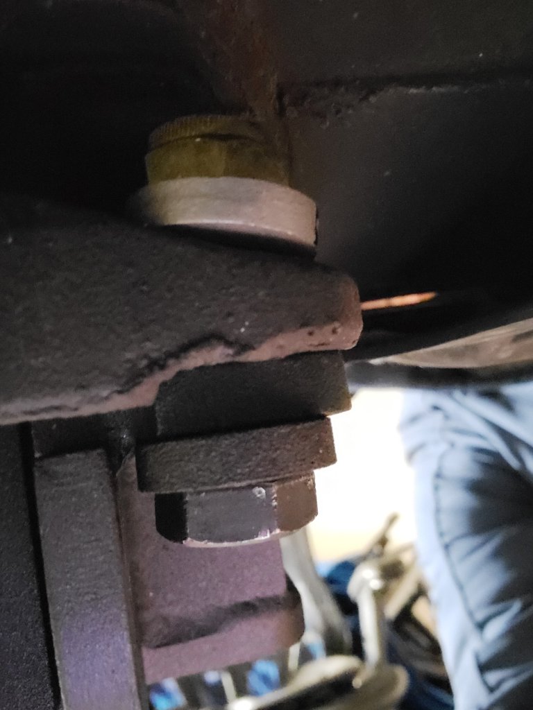

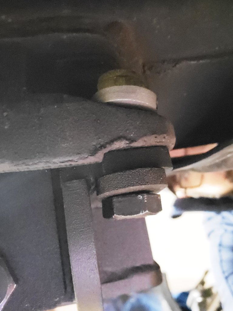

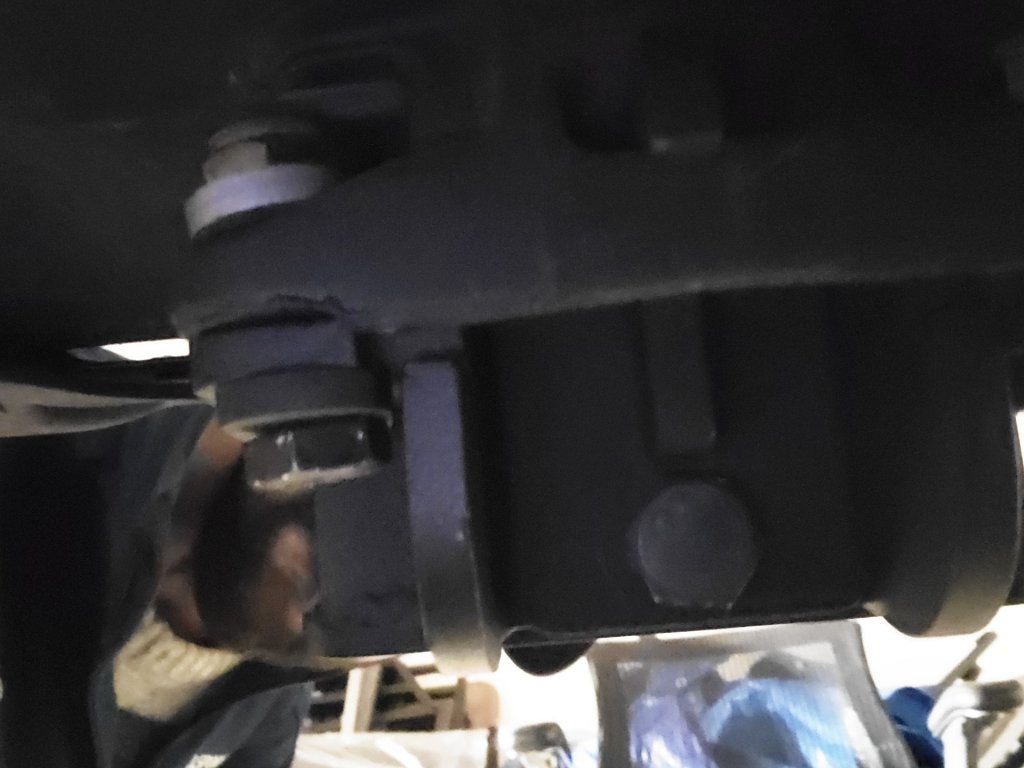

Also, I dont have a torque wrench yet so only socket wrench tight now. Looks like the seating of the bolts into the rover hitch mount arent seated great, but perhaps that's where the deforming washers come into play?
Also snagged a hitch mount cover and notched it out to fit snug around the locking pin.
Digging it.

Anyone have any insight on the bolt seating? W
