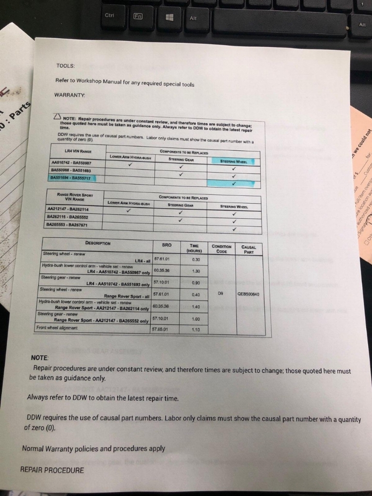

I have had three shops do balance and road force ranging from 12 to 24. I have put stock wheels and tires back on. I have had 2 ailments done. Here is the bulletin for my vin range. Just don't want to drop money on a steering wheel when nobody believes it could be the steering wheel. The whole car shakes a little. Steering wheels is the worse.
