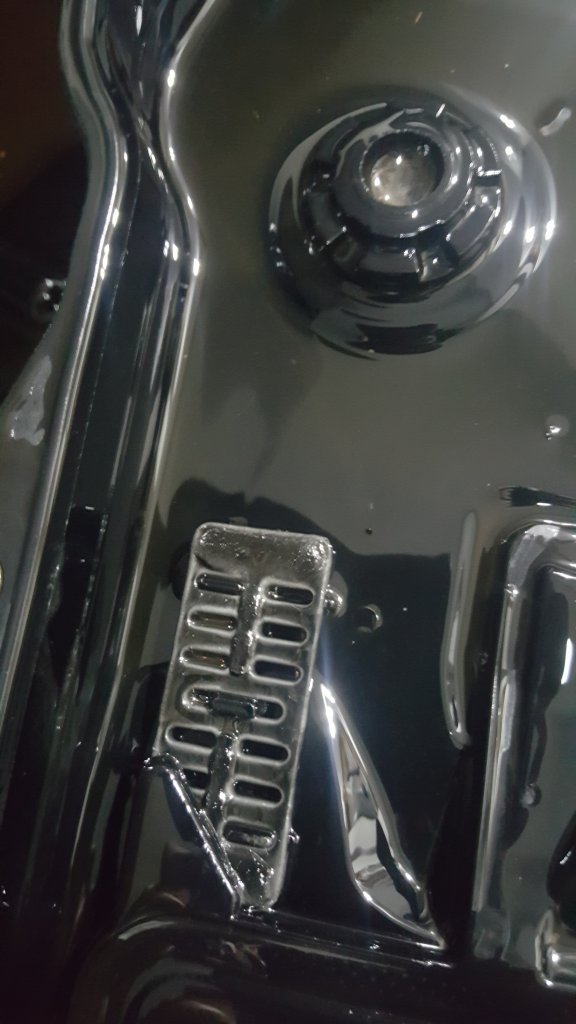

I did a transmission drain and refill at 65K, but I'm one commute short of 70K. So, today was transmission pan swap day.

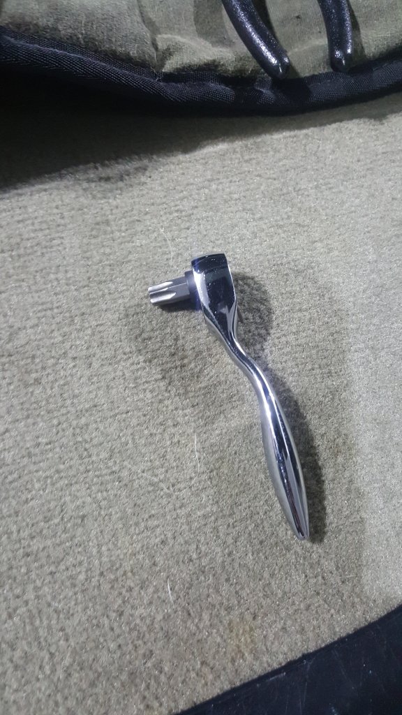

All in all, it wasn't bad. I used this little guy to get the 7ish bolts above the two cross members:
Maybe it is common knowledge, or I didn't read enough going into this, but draining the pan does not drain the pan. It was glorious to drop the pan, turn it 90 degrees, tilt it slightly, and have a nice transmission fluid shower. I'm sure in exaggerating, but It looked like a liter.

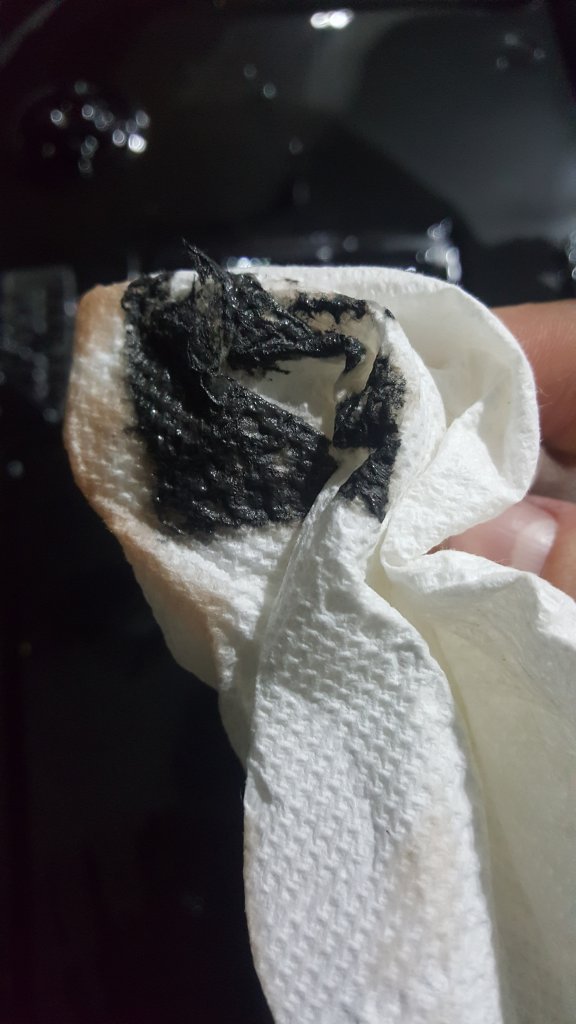

So, what are the expert opinions on my dirty magnets? They had a lot of crud attached:
