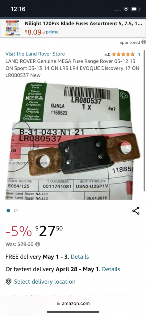

See the attached pic for Mega Fuse info. There’s many versions/brands available online.

I had done a search online and used the parts.landroverparamus.com site to cross reference this part number LR080537, but they don't list the LR4 as a valid fitment. Thanks for confirming it worked for you!

Even though it's 400A fuse, they are a " fast blow fuse". It doesn't take much to blow them.
Jump starting the vehicle off backwards can do it too.

This is great to know, LR4 won't start with particular symptoms then look at the mega fuse which is part number LR080537 and rated at 400a, a great search that hopefully helps others who stumble on this issue (perhaps us one day!).
