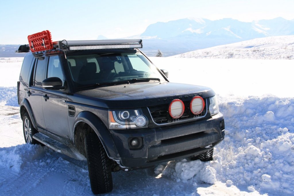

For when I go 4x4 rock climbing and wading through 3 foot snow to get the extra height and they came with the vehicle as part of the deal.
Like this weekend, last weekend, and for almost every weekend since November.
Yes I did destroy 1 tyre so far which cost 300 to replace but I think the BFG wouldn’t have survived it either.
Slid down an embankment into jagged rock which punctured and sliced my front tyre at a 45 degree to the wheel.
Ice on 20% degree unmanaged winter road. DHC tried to keep it under 2kmh but nope.

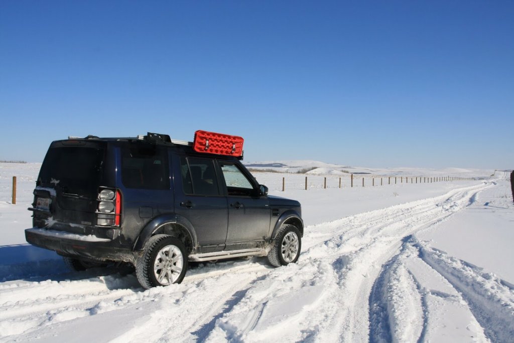

So the rods were used this weekend through snow way deeper than this. The traxx worked well when it got too deep.
However I would have loved to have more traction when I aired down to 20psi
