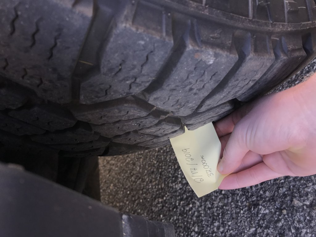

I agree with Fields Carlisle. I’ve got the 255-55-r19 duratrac on my LR 4 and they are quite noisy on the highway( nothing unbearable and it’s more like a lower pitch rumble) but these tires are GREAT on and off road. So far I’ve put around 37,000 miles on mine( had them installed at 136,000 and currently have 173,000) I took a picture with today’s date for proof that it was taken today. Tires are still at 75% I’ve done almost all highway but mixed in is probably 5-6k towing in the mountains and lots of sand, mud, and rocks. Slightly more expensive than other tire options but in my opinion WELL worth it because they hold up so well
