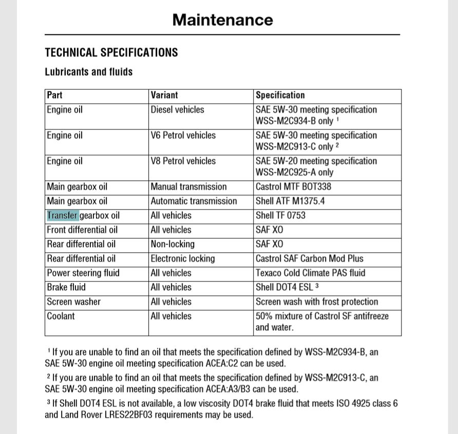

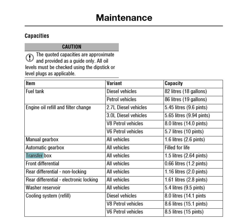

Can anyone kindly clarify oil volumes for front and rear diff and Tcase? Some say to oil filler plug level and others say an exact volume is required and to fill plug level is over filling. Owners handbook states approx. total capacity but then says use precise volume. Not v helpful.

T case is to fill plug. Diffs are specific volume. I can’t remeber what volume is, but I’d fill what was drained (unless you have a leak).

Front diff was less than a quart(.6 maybe?). Xfer case was 1.5, rear was also 1.7 or so(big rear pumpkin, mine is a locker though. Open diff is smaller). I just filled them to fill holes.

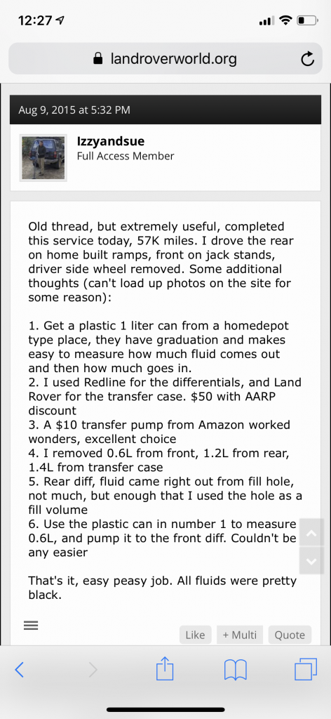

Filling to the fill holes is an overfill on these.

This is from an older thread and the volumes I used...

Just completed this maintenance. All fluids looked amazingly clean. Probably could have waited, but hiendsight is 20/20. Used owners manual volumes for front and read Diff. (non locking). Transfer case filled to the fill hole. The amounts listed by Pfunk951 look similar to my manual but off by a few 1/10ths. or 1/100ths. 2011 LR4
