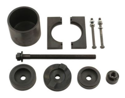

I use the OEM bushing installation cups with a threaded rod and an air impact. The bushings slide right in. The threaded rod does have to have the "ACME" style threads, for it to work.
This may be a little more practical than my press, do you have a part number for this kit?
