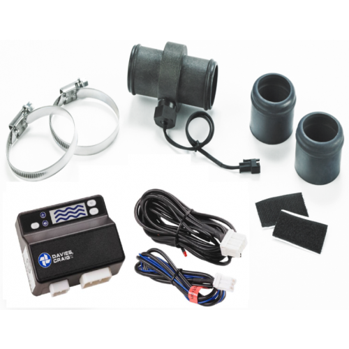

I had a catastrophic coolant loss with my front crossover pipe failing at 98k miles. The water pump was busted as well as coolant was coming through the weep holes. I knew about the issue for the crossovers since around 50k, but never got to replacement beforehand. Anyways back to the failure day, it just so happened that I needed to exit the freeway and I needed gas. I noticed the sweet smell as soon as i got out the vehicle. I ran back to push the engine button off. The AC worked fine, the temp gauge was in the middle, no lights indicating coolant loss. I opened the hood and the expansion tank is bone dry and coolant is everywhere steaming. That was really scary......how could LR design their temp sensors and low coolant sensor like this? I immediately towed it home and did the repairs with a friend. Everything is working fine thank God. It looks like i was really really lucky it just happened and i caught it early before the engine overheated.
Back to my point of this post. I was thinking we rover owners should install this device. It's very cheap insurance and would let the driver know of a complete coolant loss failure event the second it happens.

I was totally thinking of finding something like this. Because of the faulty sensor, I live with a low coolant warning on. I have to replace the sensor but maybe need to do this as well. Obviously LR can’t be trusted.

yeah man do both. Best insurance policy in my opinion.

Brave dude. Very brave.
I’m putting a kit together which would be pressure sensor operated sounding a really annoying buzzer. If there’s enough take up I’ll make a batch. If not then it’s a one and done.
any interest?

I might be, depending on the integration. I’m a bit of a nerd and would actually enjoy doing something like this myself.
My coolant crossover pipes have been replaced to the “improved design” and I travel with tools and another set of coolant crossover pipes... so... brave, but not dumb. Haha

And some spare coolant I hope ;)
op. I’m really glad you dodged a bullet with this. At least you pushed it as far as you could without a mile wasted due to premature replacement.

Yeah Stuart i know. When i hear about guys losing their engines over this, i really do feel like crap myself. Russian roulette sucks.
