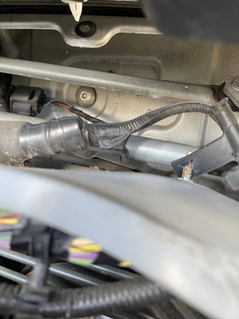

Of not, when you get to the metal dash frame, there are 2 screws holding it to the body that aren’t intuitive. First, there’s a screw under the center dash speaker grill, and it’s smaller than the others so, heads up. Finally, there is 1 bolt, I believe it’s a T50 or T60 that holds the frame in place from the outside of the cabin!!! (In pic below) You have to pull the windshield cowlings off, specifically the lower cowling, then you can get a torx socket with some extensions in there to get it off. After that you’ll be home free.
