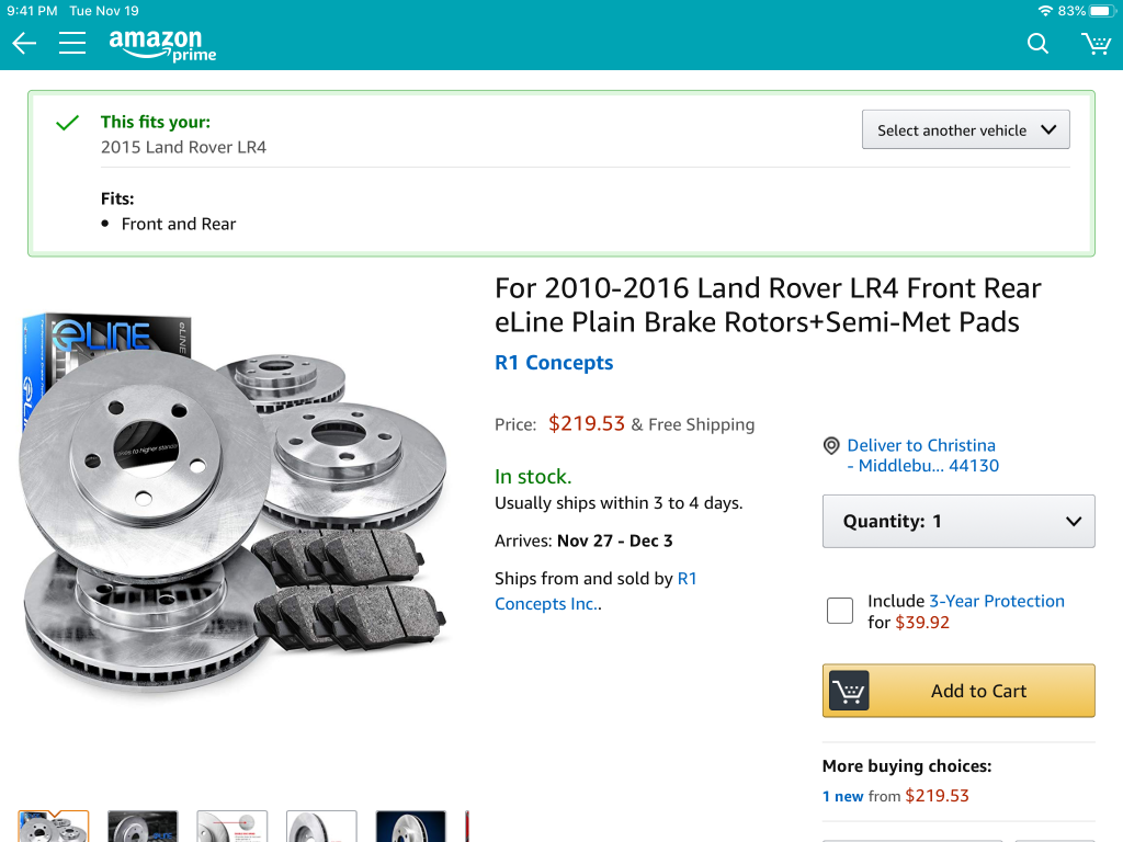

On amazon.
Without wear sensor( usually 11$ on Amazon)
