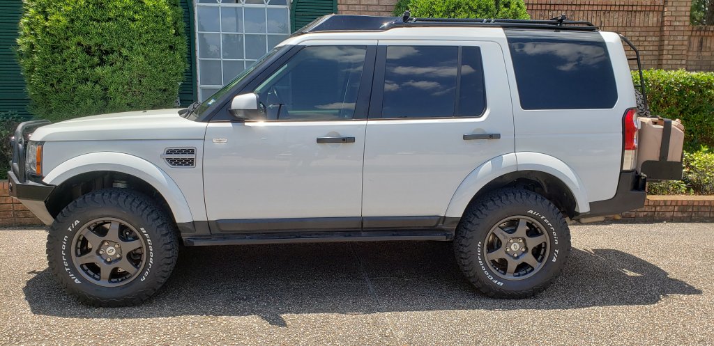

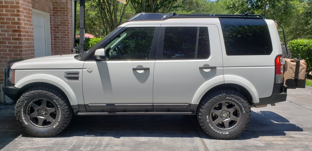

Poser pic at extended height.
At standard (+ 2"due to rods/spacers) height.

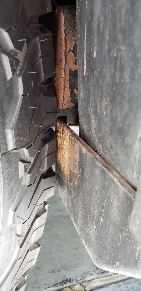

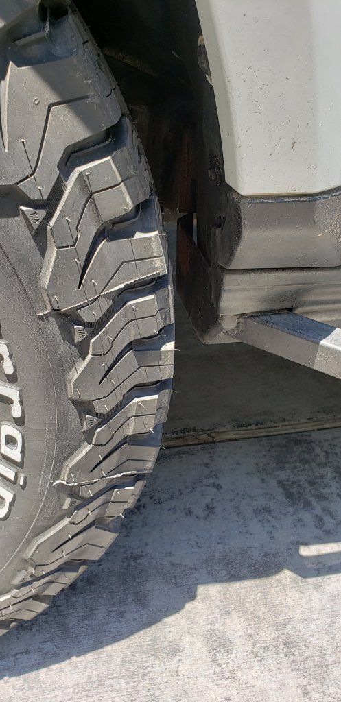

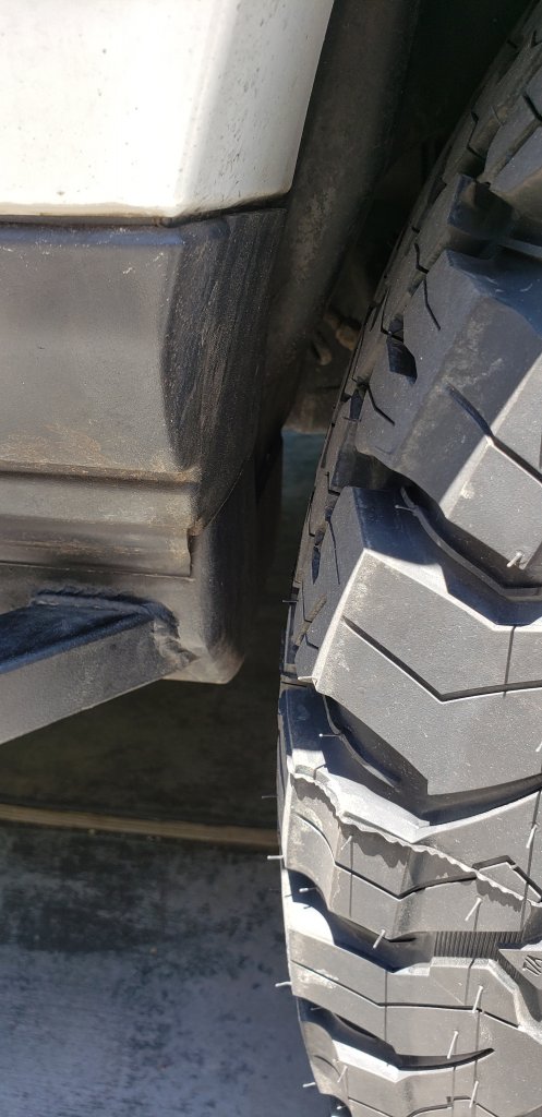

Front clearance to slider
Rear clearance to slider

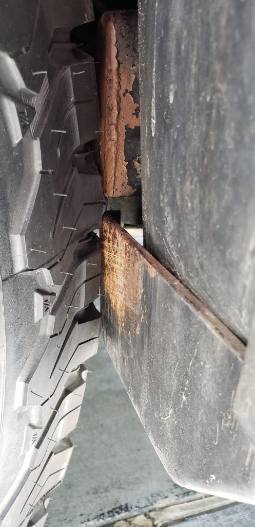

Front slider at full lock. The brown is spray paint from a previous fitment I was using to check rubbing on the slider and where my frame horns were. As I said, it is slight. One of my old setups polished those areas to a chrome-like shine.
This pic shows pretty well that the TR sliders take up a good .25-.5 inch of space that could otherwise be tire. My horns could also be cut back more aggressively, if the need ever arose.

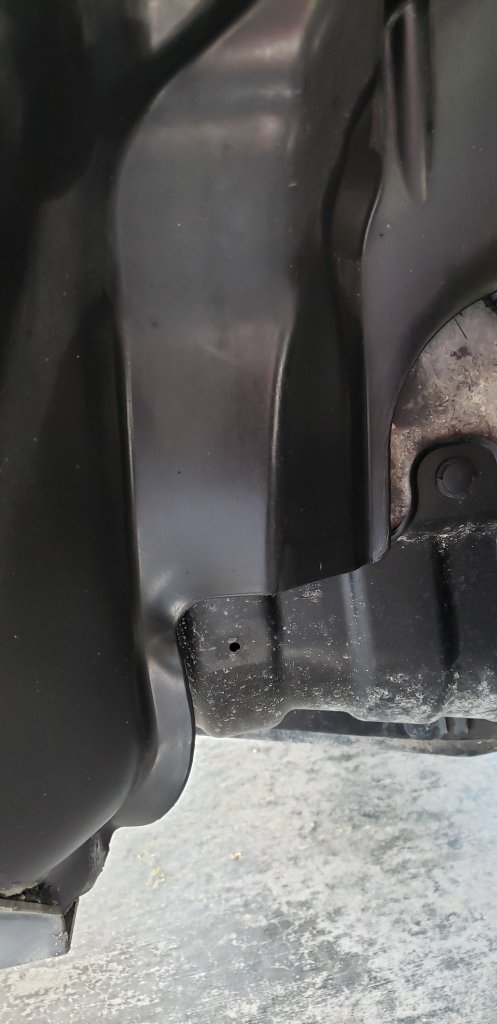

Plastic bulge in front driver's well that will need a little heat gun or trim.

I can only speak for 2012, but it took me a torch, grinding wheel and welder...;)
I was somewhat conservative. They could be cut back and patched again if needed.
With different sliders and those horns cut back more aggressively, you could get to 34.5ish.
I haven't explored what kind of cutting would be needed on the flares, but I am sure some would be required on the flares and probably fender liners as well if you are going to a 12.5 inch section width and wheel spacers
