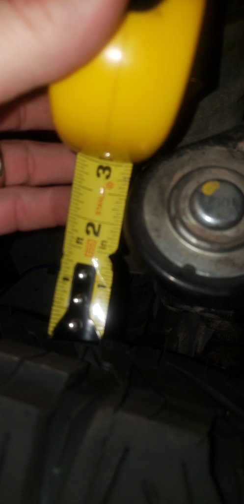

here is my promised pic of the 275 with the tape measure for reference for clearance to the UCA.
Yeah I noticed earlier that the tire is pretty close to the UCA. We'll see just how close tomorrow because my tire is approximately 0.6" wider than yours
