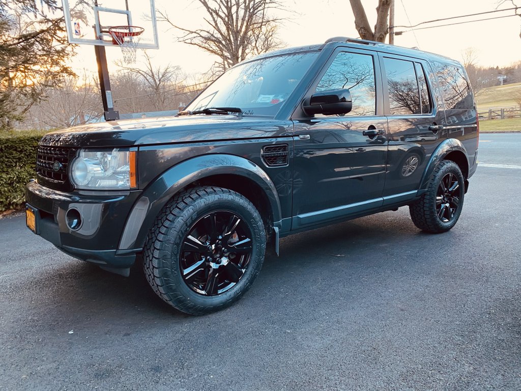

Tires are factory size 19s.
I expected the ride to be a little louder and a little less smooth when I jumped from pure street tires to an A/T but it's really bumpy at speed. I got it done at Town Fair Tire in the Boston burbs. They did a 4 wheel alignment when they mounted and balanced the tires. I had the two front tire re-balanced a few days ago and it's still rough.
I've had Duratracs and K04s on a pickup truck in recent years and they were fairly smooth.
The truck has 100k miles on it.
I'm thinking either:
-unbalanced (they tried to fix 2 out of 4 with no luck)
-tires out of round or just plain bad
-or a bad alignment (is there such a thing?)
The truck is borderline undrivable now. I'm going back to get it fixed but I'm wondering if there is anything else I should be looking at?

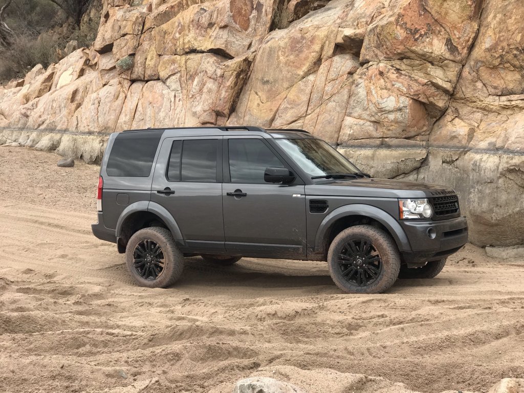

I also have a new set of these, and they ride softer than the stock Continentals. These are on 36/42 stock pressures. I got them installed at Discount Tire and they did a road force balance. Super happy with them.
I did notice they did take a bit of weight (Compared to OEM) to balance, but they are very smooth.

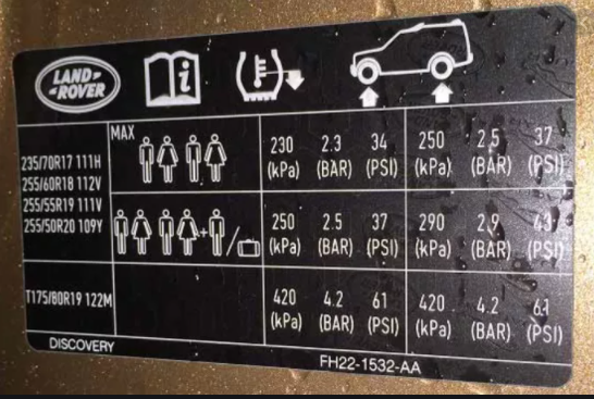

An interesting side note is the recommended tire inflation pressures. Ever since the Firestone/Ford debacle and the overly litigious environment in the USA I have noticed that inflation pressures for the US are assuming the vehicle is at max load. Everywhere else in the world where it is assumed owners have half a brain the tire inflation pressures are lower, especially in the rear. I run 34F 37R with "normal" loading and bump pressure as required if hauling near GVWR or hauling a heavy tongue weight trailer etc. Check out the placard from other part of the world:
The ride is much nicer in scenario #1 (light load)
