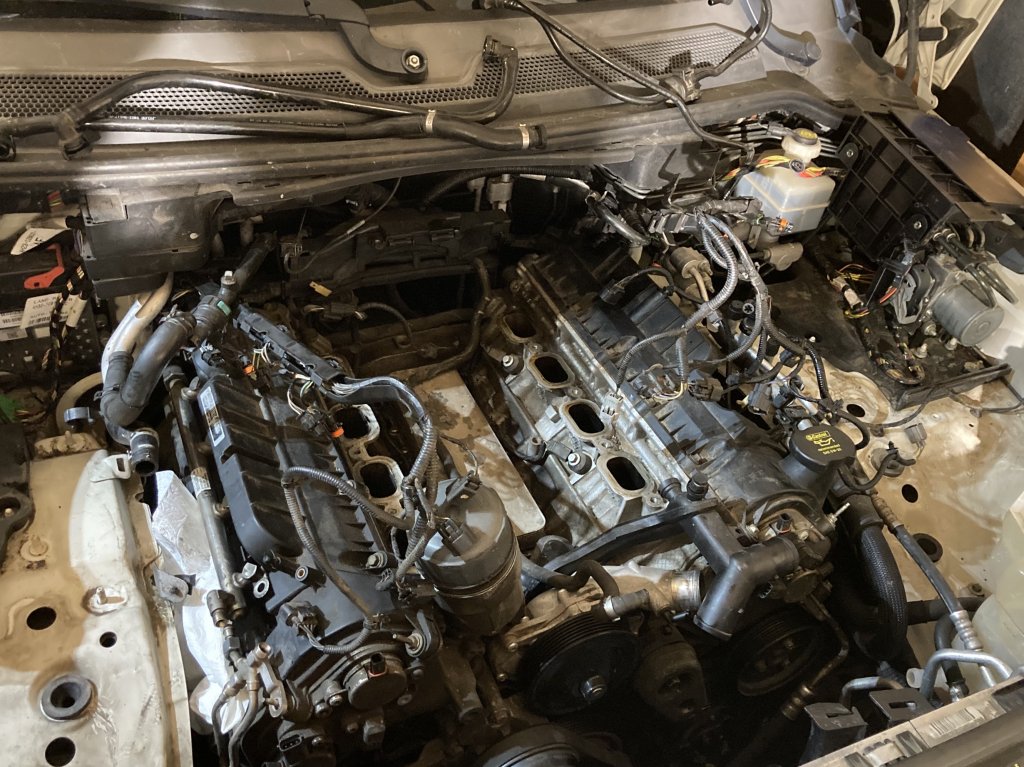

I have removed the rest of the electrical boxes, upper radiator fan shroud and fan, most of the coolant hoses including the thermostat, fuel lines, lower intake and ignition coils and spark plugs.

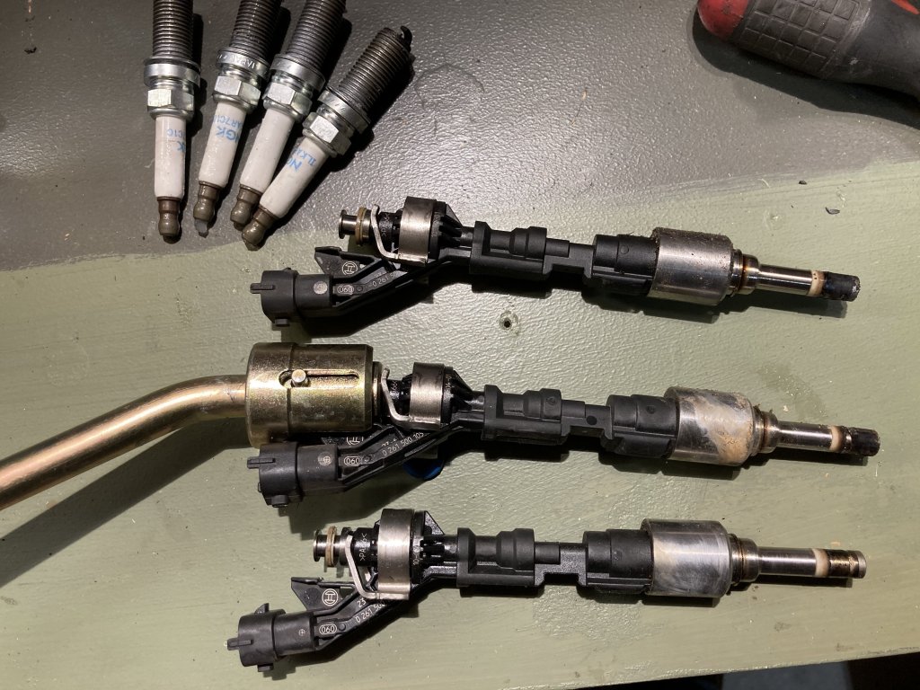

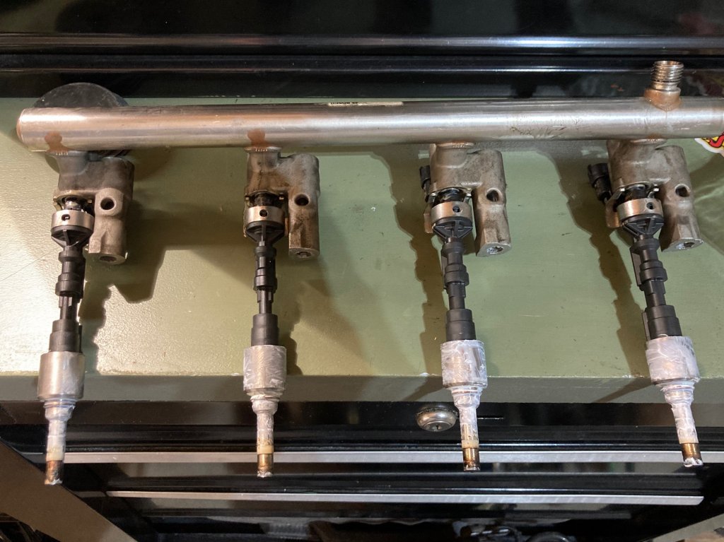

Now for the weird part, the drivers side fuel rail cane out WITH all the injectors attached... ***?
They look relatively new and clean, with some sort of white grease on them, in-line with the previous owners info that these were just replaced. Not sure why they came out so easy, I was thinking the 4 torx screws would push the injectors into place pretty well if they weren’t placed in correctly.

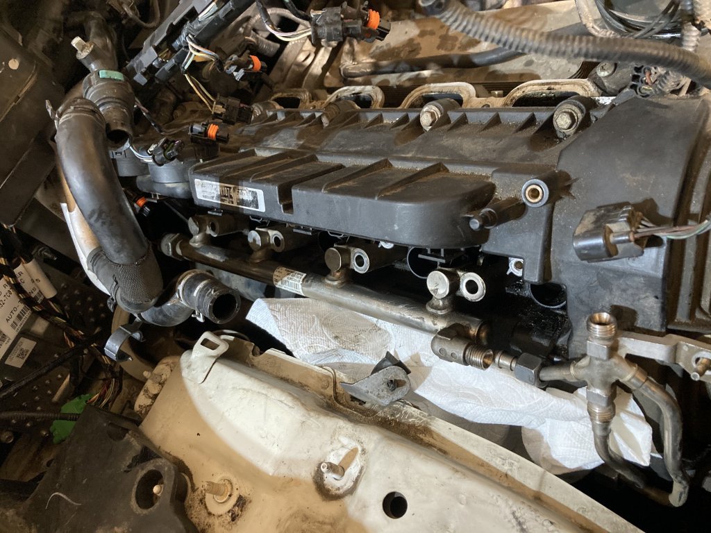

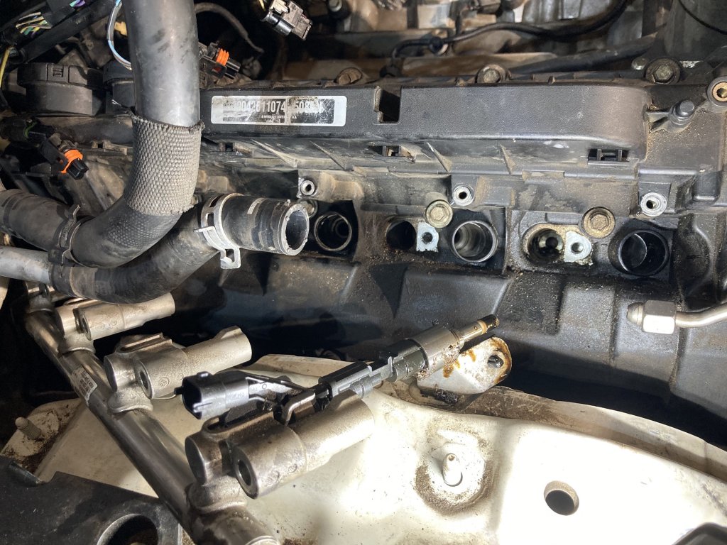

Now I’m having the opposite issue with the passenger side rail, it’s really on there snug. Any suggestions on prying this thing out?

Ended up putting a wood shim between fuel rail and a pry bar, worked my at each injector until the fuel rail popped out along with one of the injectors. The remaining three injectors had a bit of fight in them, as expected, pulled them out using my $27 Amazon injector puller! Here is the end result:

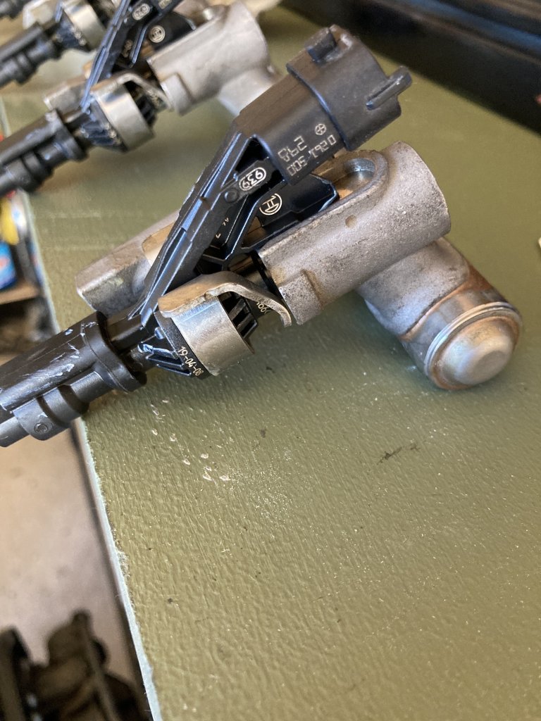

I don't remember if the injector clips provide downward pressure to keep the injectors seated, or if they clip into the fuel rail. I do know that the workshop manual tells you to remove them before removing the fuel rail though.. so, I suspect the latter.
That may be the reason that the four driver side injectors stayed mounted to the rail, and why the passenger side rail was a pain to remove.
The manual also says to replace them upon reassembly--you may have bent the passenger ones.

The clips look like they just provide downward pressure against the fuel rail, they don’t clip into the rail:

I should note that the drivers side injectors look to have been replaced recently as they have white grease and are generally cleaner in appearance than the passenger ones. I will send both sets out to get cleaned and tested before I plan on putting them in. I will also replace the o-rings and Teflon seals.
