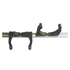

The PowerTank is typically mounted like a fire extinguisher would be. A bracket must be anchored to the truck somewhere. On your run-of-the-mill Jeep it would be mounted to a roll bar. On other vehicles it would be mounted to the floor of the cargo area. It should be mounted to steel. The OP is having trouble finding a worthy place to drill holes. The floor of the cargo compartment is the third row seatbacks. The sides of the cargo area are plastic.
How's this? Mount the Powertank bracket to a piece of plywood. Use ratchet straps to strap the plywood to the back of one of the stowed third row seats.
PVC - that is the word! I was going to say that I would make it myself, but was not sure what off - PVC sounds great.... For the no-drilling option, an ad hoc rack made from PVC pipe would work fine. It could be tied down using a ratchet strap and the child seat anchors on the backs of the second row seats and the anchors on the floor.
A search for "SCUBA tank racks" will reveal a plethora of ideas.
