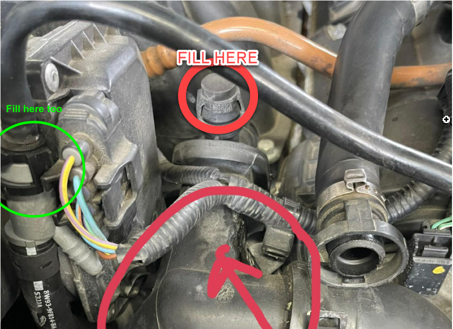

I just recently did the rear crossover pipe on my 2013. It was more of exercise in patience than difficulty. Access is limited and its not a natural position to work in. There are a lot of great writeups and videos on the procedure. The only part that was difficult was getting the torx bolts out of the crossover pipe as there is little room between the pipe and the firewall and there is a lot preventing you from turning a ratchet. I think a short handle 1/4 inch ratchet is a necessity. On several videos and threads I found it was advised to tear down the wire loom cover that runs above the crossover pipe. I chose not to and was able to work around it. One piece of advice is to mark the electrical connections when removing the intake manifold. There are two plugs back there, one goes to the crossover pipe and one to the intake manifold. They are the exact same plug and can easily be mixed up. I can say from experience the car will not start with them swapped. Also be mindful of the plastic vacuum and coolant hoses, as I broke a small plastic coolant hose as I was trying to hover over the engine compartment to reach the crossover pipe bolts.
Something I found that was not covered in writeups and videos is the need to top off the cooling system via the bleeder. Its also an important step not to skip because you can easily overheat if you only top off the reservoir. Also at 90k miles the plug just disintegrated when I removed it so I had to make an unplanned trip to the dealer. I think it was $7, worth having one on hand in case. Pop that plug and use a funnel to fill with coolant until its full, replace the plug. Someone may be able to correct me but I have used that process on 4 occasions with success.
For location, ignore the hand drawn circle and arrow. For reference that is the throttle body on the left.
Part# for the plug: LR011038G

@shinckley08 If you "fill here too", it'll get coolant to the rear of the block and it will have enough coolant to push air pockets out of the block. It makes it easier to burp the system without a coolant vacuum tool.
