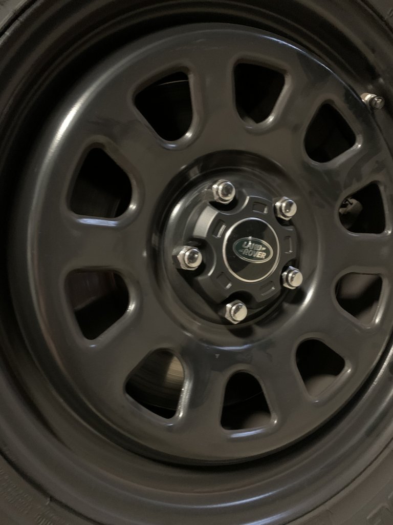

On lucky8’s sight the only wheel that requires no modification to the brake caliper or spacers are the Compomotives. If your looking for a more budget friendly 18’ wheel you’ll have better luck with the Tuffants 18’ for LR4. These require no modification to get the wheel on the car and depending on the tire you pick you might not have to shave the frame horns down either. I ran tuffants with 265/65R18 Nitto Ridge Grapplers without any problems. Here’s the link to their sight a long with a picture of them. (Not the best picture I can provide more later if you would like.)
