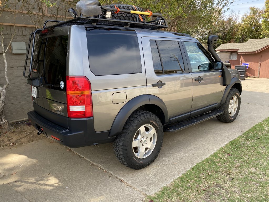

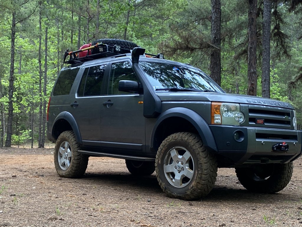

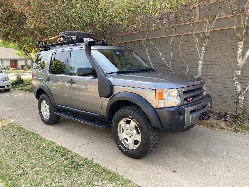

2008 LR3 on 33’s
Just to clarify, unless you add the lift rods, the Lucky8 SYA kit alone does not lift the vehicle. It does keep it up 2” higher in an EAS failure. For me, it’s the only proper way to use the lift rods, with the SYA strut spacers. It also saves your air bags and close to factory ride as it allows the bags to maintain close to standard extension and pressure when you do have the rods in place.
I have 2.5” Proud Rhino lift rods and the 2” SYA kit (w/straps!) so my bags are only inflated 1/2” past factory spec. Again, the SYA kit does not raise anything. It just allows the bags to not do all the work on the lift you get from the rods.
Also... the gap tool is highly recommended to anyone messing with the EAS or running a modified Air Suspension. Invaluable on the trail or the road trip in the event these finicky ole trucks start yelling at you.
