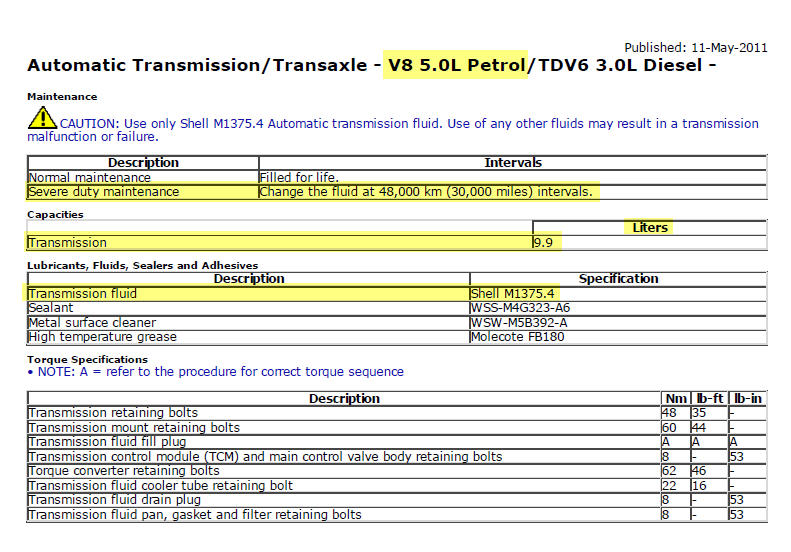

I believe he used Rowe 9006 which according to some is an equivalent. I told him to use Lifeguard when I dropped it off and he wrote life guard 9006 @$11 a qt on the receipt so I believe this is the stuff:
https://m.eeuroparts.com/Parts/57042/Auto-Trans-Fluid-HIGHTEC-ATF-9006-Lifeguard-6-1-Liter-ATF9006/
As an update, I called him yesterday and explained the situation. I wasn’t threatening in any way upon first talking to him. I said the truck never had the downshift buck between 2-1 and never made the hum it does between 2-3. He immediately got defensive and said that’s how the truck came to him and it’s a very simple procedure that he did. Again I wasn’t threatening in any way and asked is it possible it wasn’t filled correctly. Without hesitation said no. I told him I was going to have it towed to the shop because I’m concerned about driving it so he could take a look at and he said “no, I’m not getting stuck with it”. He said for me to drive it in and he will take a test drive with me to reset the adaptations. I’ve never once did this in my life, but I think I may need to get a lawyer on this one. I have a very bad feeling about all of this.
