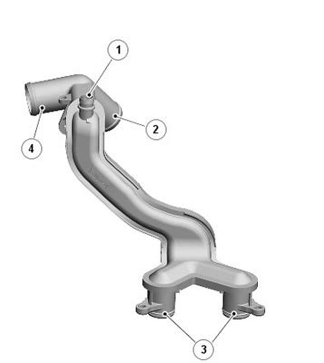

Do we have a close-up view of the failed part?
blacktie
Sep 16, 2014
29
I'm in on this as well- will someone post a picture of the crossover? I have a bunch of friends that are in NASCAR, INDY etc... I bet they would be able to help.

I'm tempted to buy a part since I'll probably need one eventually anyway and look at the design in detail.
